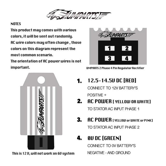

fastbob, the 6 to 12v conversion happens at the r/r. I'm posting the wiring diagram. remember this is only the lighting side. the ignition is primitave but effective. it runs ac full wave unregulated. its unregulated because it has a dedicated ac stator coil. effective because ac is full wave by definition so it need no conversion. putting a brand new ignition on this bike is as easy as replacing the points and condenser.
here is the 4$ modern scoot r/r. could this be any easier? and if you would like the trade secret circuit diagram and explanation of how it works I also can post it and explain, but be warned I'll have to bring up trump to do it. sorry.
