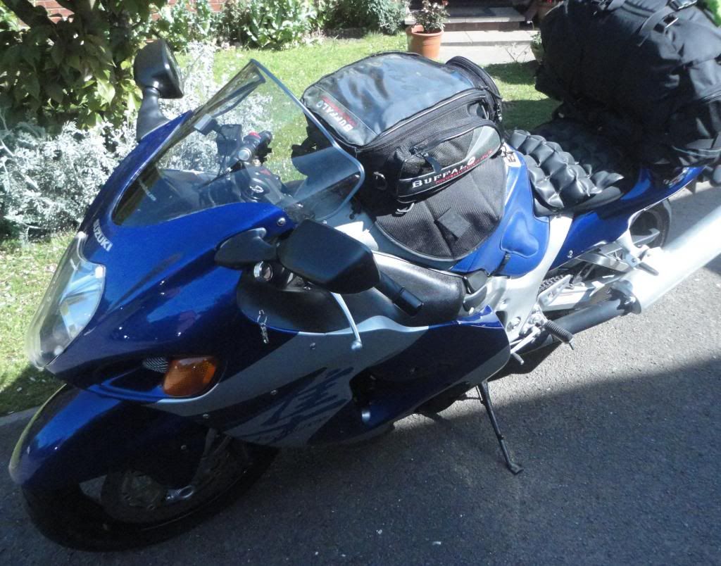

I've always wanted one of these bikes and in 2013 I was very lucky to find a mint gen1 with sub 8k miles on it, mot history showed 18 miles per year for the last 8 years ( to the mot station and back ) I was a bit intimidated by this bike at first, huge power and a bit lardy ! however now I will never sell this bike.
At the last Motorcycle live at the NEC I sat on loads of bikes including a 2015 Hayabusa & GSXR600, the sitting position on the gixxer6 felt just the same as the Busa, some weight on the wrists with a forward position but this feels completely fine when you're moving, after all the bike is designed to hit 186mph. The tank is easy to grip with the knees, you can move about on the bike but I tend not to do this and when I have it seemed to make little difference ( lardy effect ?!)
Mines a gen1 unrestricted model which is irrelevant with power commanders available but one difference is Suzuki over engineered the cranks in gen1 which are cast in stone & bullet proof, hence so many gen1's are turboed / supercharged etc and dragged, I've read there is nothing wrong with gen2 cranks though. Whilst writing about the engine back in 1999 175 bhp was truly awesome, surpassed now by quite a few but the 1299cc IL4 is a brutally effective beast with a huge 102lb peak torque means instant shove. 35mpg for sane speeds, fuel injection is linear with no flat spots or snatches. Everyday riding is easy with pull from 1500rpm the busa puts out over 75lb torque at 4000rpm so plenty of midrange grunt means easy overtakes; 3rd gear, what a gear you can hold 3rd gear pretty much the whole time on a fun run !
I've changed to a double bubble screen to help chuck some more airflow over my head being over 6 foot tall so sorry MR Koji Yoshiura but it doesn't ruin the look and helps keep even more weather off me as well. The standard seat is very comfy with a Seat height of 805mm so very manageable especially for shortbums and has strong grab rail.
Brakes were criticised on the busa it said it's 200mph bike with 140mph brakes which is tongue in cheek but the brakes will fade if you consistently shove for too long, braided lines help, that said this bike isn't a scratcher and will feel a bit laboured almost imprecise if going fast through multiple twists, however at sweepers and obviously straights this bike is razor like and will warp on undisturbed by mid sweep bumps I tested this on the Autobahn and tucked in the busa sods off like the starship enterprise.
If a mate is following you he'll notice the PAIR immissions system kicking in injecting air into the exhausts to burn unburnt fuel, the view your mate gets is an afterburner glow with the occasional flame :-)
The looks are marmite and dated for some however I have several superbike books and this bike is in there with words like iconic.
The back torque limiter helps manage downshift loss of traction to the rear tyre.
Shite horn, I've upgraded to dual Stebel Nautilus.
Good headlight but expensive if it gets bust so a headlight protector is a must.
Steering damper is hidden below the yolk and I think this makes car park manoeuvring harder but obviously helps stabilise on the road, the busa has fully adjustable suspension, get this set up professionally it's no more than 20 quid and makes a big difference.
Clutch is towards heavy side so urban cycle can be tedious but fine on the open roads. I could be tempted to a dynojet ignition module and dynojet quickshifter.
Mirrors are good with almost no vibration, clocks look dated but hey mine says 220mph ;-)
There is no centre stand so an abba type stand is a good investment.
Insurance group 15.
I wouldn't want to replace this bike, I would recommend the busa but as with all bikes its personal choice, it is nice that even most cagers recognise what's just overtaken them, last year parked up near the Nurburgring amidst the countless BMWs and other tourers my bike had the most folks saunter up and give it the once over. The busa will pootle about with a nice gurgle but wind on and it will give an intoxicating growl and has the ability to increase the rotational speed of the Earth
Good for touring except a tankbag restricts the ability to tuck in :-(
Funky bonnet prop tank thing
If it cant be fixed with a hammer you have an electrical problem
